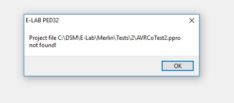

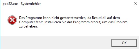

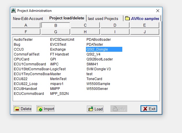

Gepostet: 21.09.2021 - 16:14 Uhr  ·  #75
Hello Merlin, I have now uninstalled my AVRco and reinstalled yours, there are some errors when starting, I think you should delete all your projects in Project Administration.
But see for yourself the pictures
DE::::::::::::::
Hallo Merlin, ich habe jetzt mein AVRco deinstalliert und deins neu Installiert, es kommen beim Starten einige Fehler, ich denke du solltest alle deine Projekte in Project Administration löschen.
Aber siehe selbst die Bilder
PS...
And a dll is still missing
Und eine dll fehlt noch
Re: AVRco Service
Gepostet: 21.09.2021 - 17:39 Uhr  ·  #76
EN
Hello Merlin, I have recompiled my current code for my maturity cabinet with your update and everything is working.
DE
Hallo Merlin, ich habe mein aktuellen Code für meinen Reifeschrank neu mit deinen Update comiliert und es geht alles.
Re: AVRco Service
Gepostet: 21.09.2021 - 17:56 Uhr  ·  #77
Hi Frank.
Thanks for feedback. In the absence of knowing what to include in a full install, I copied my own AVRCo directory - completely forgetting that the ped ini file will have my projects in it! Oops. I will try to find the default on the ftp site and substitute that.
beauti.dll is in the install, so not sure why it has not installed in the right place on your machine. It should be in the IDE folder. Perhaps there is an issue with the start directory in the launcher. Did you launch by accepting the run program option from the installer, or from the start menu?

Re: AVRco Service
Gepostet: 21.09.2021 - 18:29 Uhr  ·  #79
Hello Frank.
A misunderstanding, I think.
I think I found the issue re dll. There were 2 copies of PED32.EXE, one in AVRCo and one in IDE subdirectories from the install directory. On install exit, the wrong one was being called (although the correct one was being called from Start menu). Have sorted that.
Am installing update now but will take a while (about an hour) during which time the download will not be available.
Thanks

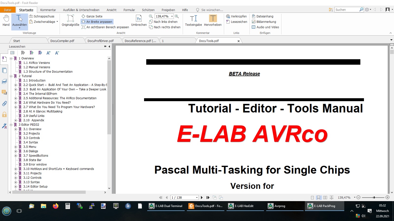

Gepostet: 22.09.2021 - 05:47 Uhr  ·  #80
Good morning Merlin, just restarted my computer, please look at the picture,
my FoxReader and parts of AVRco are started at the same time.
DE:::::::::::::
Guten morgen Merlin, habe gerade meinen Computer neu gestartet, schaue bitte auf das Bild,
es wird mein FoxReader und auch Teile von AVRco gleich mit gestartet.
