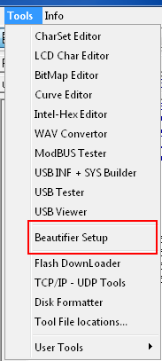

@all,
the new Beautifier is now intergrated into the AVRco system.
The well known Beautifier button can be used now to start this tool.
For experienced users the setup of this tool can be changed through the
Beautifier Setup menu.

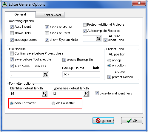

@all,
now it is possible to switch between the old/previous beautifier and the new one.
Dialog "IDE/General Options", see below.
