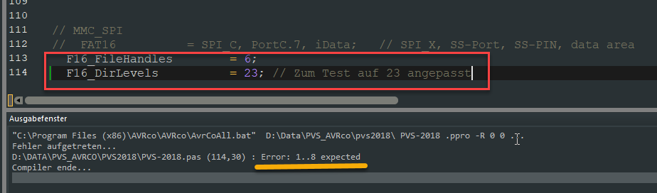

Ok, ich habe es mal mit 23 versucht.
Aber der Compiler kann das nicht übersetzen "1...8", max. ist hier 8.
Ok, I tried it once with 23.
But the compiler can't translate that "1...8", max is 8 here.

Does 8 fix the problem in this case?
That gives a path length of 88 characters, which would probably be enough here.
\Android\com_go~1.y~1\files\offlinet\gUGab~1\streams
which is too big for 4 but well within 8 depth.
It is not a good solution but would at least prove that this is the issue.
