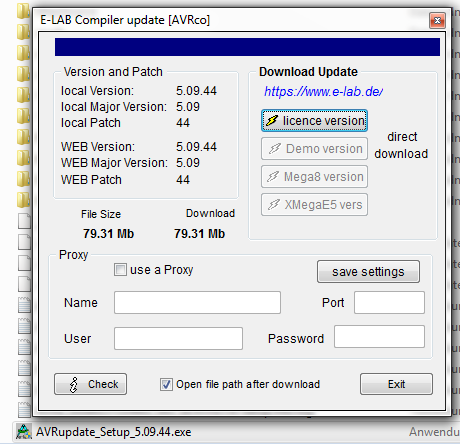

Gepostet: 11.09.2018 - 22:21 Uhr  ·  #51
Hi @all,
Miparo hat eine Standalone Version des Internet Updates erstellt,
die dann in den PEDnew eingebunden werden soll.
Bitte testet das mal ! Bei mir funktioniert es damit.
Achtung: die Proxy Geschichte geht damit noch nicht !
Miparo provided a stand_alone version of the internet update.
It will be integral part of the next PEDnew.exe.
Please check it ! At my side it is working.
Note: proxy functionality is not yet implemented

Re: Update funktioniert nicht
Gepostet: 12.09.2018 - 08:07 Uhr  ·  #53
Funktioniert :)
Aber ich würde doch gerne selber bestimmen, wo meine Downloads gespeichert werden ;) .... und zwar vor dem Download.
[Edit]@Gunter: Aber hoffentlich doch auch in den alten PED32???
Gepostet: 12.09.2018 - 10:47 Uhr  ·  #54
Hallo Gunter,
mit der Standalone läuft es sofort ohne Probleme!

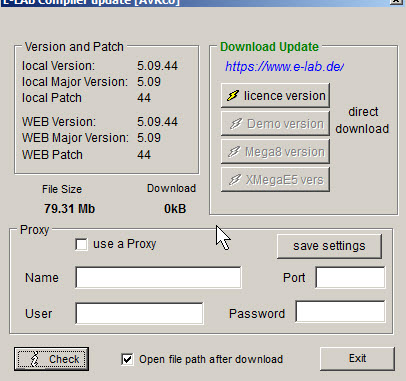

Gepostet: 12.09.2018 - 13:20 Uhr  ·  #55
@All. I would like to share my own experiences. Perhaps someone smarter than me can make sense of it.
1. I have a version of the PEDNew that connected for update exactly once. After that it had a catastrophic effect on my system, which I will explain shortly.
2. v5.9.44 works fine PROVIDED I do not run PEDNew.
3. If I run PEDNew, then neither it nor the original PED work any more. Systems are exactly as described above - zeros in all the fields. But more all communication with the server is lost, including access to this forum.
4. I can recover by powering down and powering up the router. I imagine that this has the effect of giving me a new IP address.
So, my instinct is that it is the server itself that is blocking me, not any of my equipment. I suspect that it is seeing the PEDNew communication as some kind of attack and blocks that IP address against further action.
These observation may not correspond with those of others, and as I say someone who knows more than me may tell me I am talking nonsense.
On the other hand they may shed some light on the situation.
I have not tried (as far as I know) the stand alone PEDNew described by Gunter, but be aware that for me a similar (if not the same) version also worked once, but after that it was a disaster.
Merlin.
Gepostet: 12.09.2018 - 15:04 Uhr  ·  #56
@all,
Miparos WebUpdater is extended now.
It supports Proxi and a user settable destination path
