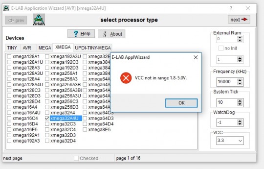

Hello Merlin, if you're at it, can you see if you can change that?
If you select the uC I would like to set the voltage 3.3 volts, but that does not work, only when you enter 3.3 volts by hand you continue, you have 3.3 in the selection, 3point3.
correct is 3comma3
Hallo Merlin, wenn du gerade dabei bist kannst du mal schauen ob du das ändern kannst ?
Wenn man den uC auswählt möchte ich die Spannung 3,3 Volt einstellen, das geht aber nicht, erst wenn man mit der Hand 3,3 Volt eingibt gehts weiter, ihr habt in der Auswahl 3.3 drin stehen, 3punkt3.
richtig ist 3 komma 3

OK Thanks Frank.
I will sort the install first.
I guess the last issue is with the dsc file?
Not sure that I understand your comment about the comma vs stop. I know in Germany the decimal point is comma, and in UK it is full stop but if you are referring to the app wizzard box, I imagine it has always been like that. I certainly haven't changed anything in that area.

Of course I have compiled the Wizzard with an English compiler....

Good morning Merlin, I just deleted all files in my AutoStart, now everything is ok.
Greetings Frank
Guten morgen Merlin, ich habe alle Dateien in mein AutoStart einfach gelöscht, jetzt ist alles ok.
