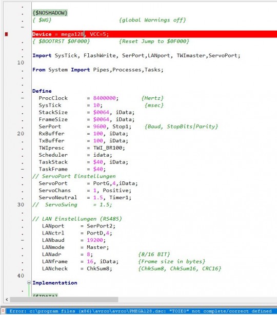

I quickly tested a few projects, I got a problem with an old one.
There, I use a mega128 and the error message is :
Error: c:progamm files (x86)....avrcoPMEGA128.dsc: "TOIE0" not complete/ correct defined
PMEGA128.DSC
[controlbits]+
as0=8
toie0=1
ocie0=2
Is the entry with the plus sign the problem?
No errors occurred with XMega CPUs (XMega32A4U, XMega384C3).

Hello Thorsten. I found that error too and commented on it earlier. Yes it is that + sign. The old compiler uses an unsupported component which is insensitive to that. The built in Delphi object unfortunately does not ignore it.
Thanks for testing and letting me know.

@All. Sorry, I should have include the corrected DSC file in zip file.
Here is the corrected zip file.
