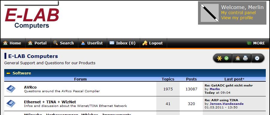

If I need to recompile a project when the PED loads, when I click the OK button in the dialog 'Error in symbol table - recompile project', at least one (it can be more if I move the mouse) shadow appears that sits on top of everything. You can see it the attached image just above E-LAB.
It stays visible on all applications until I exit the PED.
It is a shadow from a hint message on the window behind the dialog box, and I think it is to do with files loading after the dialog box executes. I think if the dialog box displayed only after all files had loaded for the last time it would be OK.
Merlin.

Gepostet: 06.06.2011 - 11:08 Uhr  ·  #14
@all,
yes, the download/update install should be fixed from this download on.
This ghosty small rest of a hint is showed sometimes like Merlin said. No idea to avoid this in general.
