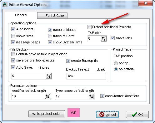

Hello Neil,
maybe your problem is here

Re: Project source files are always Read Only - Why?
Gepostet: 21.06.2011 - 12:18 Uhr  ·  #14
Hi Rolf,
Yes this makes a difference. If NO Warnings are enabled it does not come up in ReadOnly mode.
Still, why would turning OFF all warnings cause it to come up in ReadOnly mode? Enabling any one of the warnings stops the ReadOnly mode.
Neil.

Gepostet: 29.06.2011 - 14:23 Uhr  ·  #16
Hello Neil,
this can happen if the same project name exists in different TABs, mainly also in the project TAB.
This must be avoided because the TABs are only for "visual" purposes. On load time then there maybe a problem with protection and/or wrong file loading!
