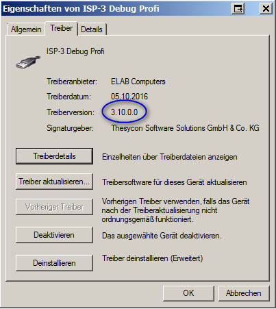

Re: ISP-3 Driver "not migrated" after recent WIN10 64-bit update, help!
Gepostet: 19.09.2017 - 20:09 Uhr  ·  #15
this shows Win7/64 with the newest driver
Gepostet: 21.09.2017 - 11:37 Uhr  ·  #16
Yes, I have the same driver version, but Win10.
With this driver I can start programmer(s) from IDE 'Prommer' button and everything works fine, can read back or program chips etc.
