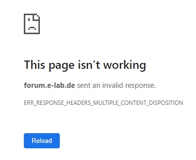

Sorry Golf, I am unable to download - I get
'This page isn't working' when I try

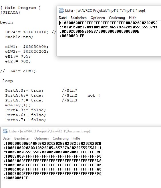

Also, which compiler did you use, Beta or Beta2?
Re: Tiny412 Compilerfehler
Gepostet: 07.01.2022 - 11:12 Uhr  ·  #10
i used beta2, version of the beta that offsets the .eep file to zero.

Excellent. Thank you Golf.
But sadly I still cannot download. I tried both Chrome and Microsoft Edge. It ups the download counter on the site but I get the same error message on both browsers.
It tells me what I need to know, though, so don't worry about it.
Gepostet: 07.01.2022 - 14:06 Uhr  ·  #12
Zitat geschrieben von Merlin
Thank you golf.
I have not yet had a response about whether the ISP3-X also needs this offset variation.
Many thanks.
Hi Merlin,
all ISP3-X file offsets (flash/eep/usr) begin at position 0.
The AVRprog manages the chip offsets itself from the dsc files.

Gepostet: 07.01.2022 - 14:10 Uhr  ·  #13
Maybe it works with the pdf.
I wanted to test the Serport, but then nothing works.
Vielleicht funktioniert das mit pdf Anhang
Ich wollte noch den Serport testen, aber dann funktioniert nichts.
Gepostet: 07.01.2022 - 14:30 Uhr  ·  #14
@Miparo
That is bad news.
It means that those using Atmel ICE need a different eep file (and indeed USRROW, etc) to those using ISP3-X.
But thanks for the info.

SerPort should work for Tiny412. Another user uses serport for Tiny412 and for him it works. Maybe he does something different. Download still doesn't work. I will try rebooting the machine and see if that works.

Hi golf.
It there a comma in the file names you are uploading? That, apparently, is the most common cause for this error.
Gibt es ein Komma in den Dateinamen, die Sie hochladen? Das ist offenbar die häufigste Ursache für diesen Fehler.

Gepostet: 07.01.2022 - 14:42 Uhr  ·  #16
Hi Merlin
Also Atmel files start from 0 !
Forget the EEprom offset in the hex file, it is only used internally.?
