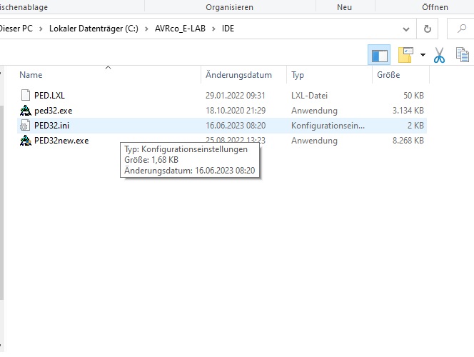

@Merlin, I've started AVRco several times, I get an error every time...\IDE\AVRpas.Ctrl would be missing.
Was the IDE directory always this empty?
Greeting Frank

Ah, it seems you have the answer Frank. This is the IDE directory which should have much more. I will update the 6.0.0 install to include the extra files.
In the meantime I attach some of the key missing files. If I am missing any more, please let me know.

Hello Marlin, now I can compile, but I still get an error AVRco.exe is missing.
Greeting Frank

'Hello Marlin, now I can compile, but I still get an error AVRco.exe is missing.' Yes that is probably because you are effectively using my CTL file. You will need to change the System Admin to point to the compiler and optimiser. My control file points to my development version (which obviously you will not have). Sorry about that. Here is correct version.
