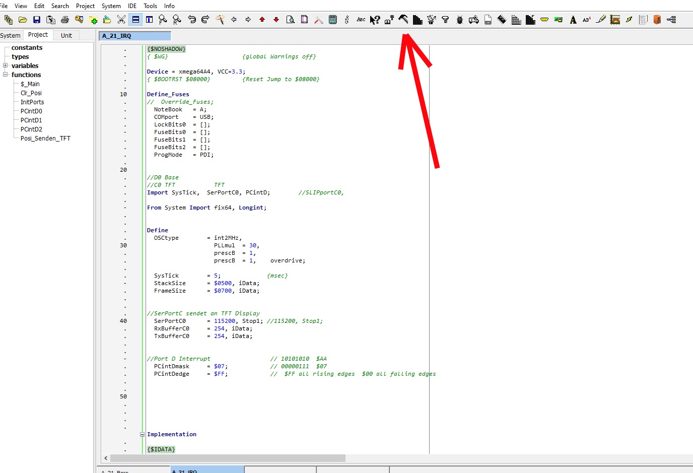

Now I've loaded an existing project and lo and behold I can't compile?
@Merlin look at that.
Greeting Frank
Jetzt habe ich ein bestehendes Projekt geladen und siehe da ich kann nicht Compilieren ?
@Merlin schaue dir das mal an.

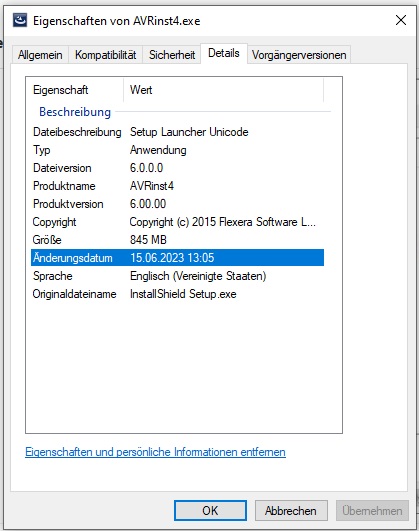

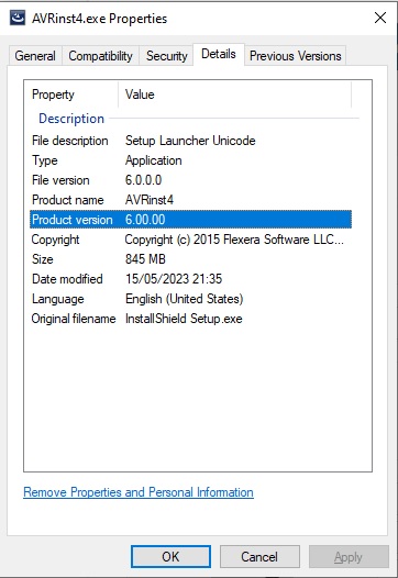

OK Frank. I have looked at the full install and it looks OK.
To help me can you right-click on the AVInst4.exe file and select properties. Click on the details page and tell me what is in the Product Version field. (Not sure what the names will be on a German machine but this is what it looks like on an English machine)
Re: AVRco 6.0 Test
Gepostet: 15.06.2023 - 18:58 Uhr  ·  #7
Hi Merlin, looks like we have the same dates.
Greeting Frank
Hallo Merlin, sieht aus als ob wir die selben Daten haben.
Re: AVRco 6.0 Test
Gepostet: 15.06.2023 - 23:00 Uhr  ·  #8
Then I am struggling. All I can suggest is that you exit the PED and try again. I once lost the icons like this, but they came back when I closed the program and restarted it. Don't reinstall again.
