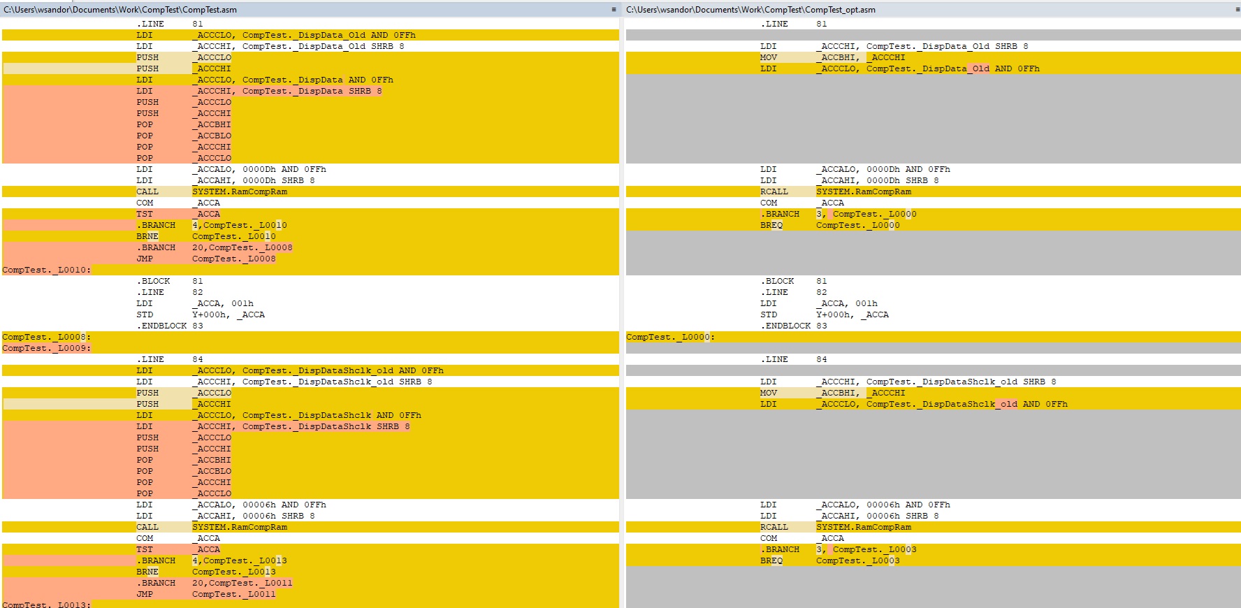

I've attached a picture about a WinMerge of the two asm files. The left side is without the optimiser. Maybe I miss something, but as I see, the optimized version sets only the _DispData_Old's and _DispDataShclk_old's addresses and doesn't set_DispData's and _DispDataShclk's before calling SYSTEM.RamCompRam. What is your opinion?

Yes it looks like you are right. I must have been looking forward to my holiday too much! :-)
I will check it out.

Please find attached a new optimiser that I believe should solve your problem.

Thanks for the new optimiser, it solves the problem!

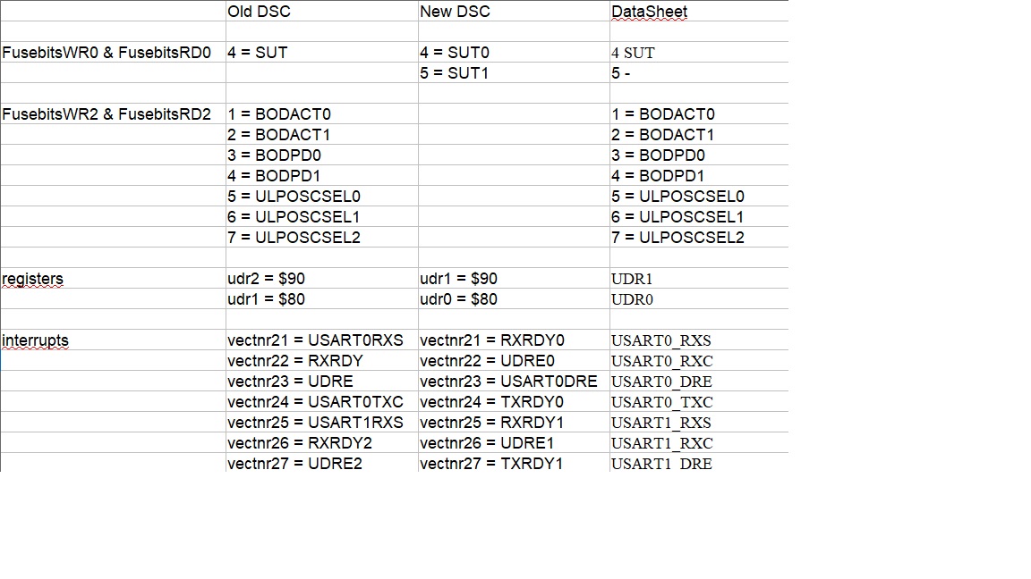

In the meantime I run into an other problem. It is not related to the optimiser but the dsc files.
One of my old projects uses the ATTiny841 (441) chip. I tried to compile it with the new compiler and get many errors. The problem is that the dsc files changed from that they were in ver 5.x. The date of the "old' dscs are 2016. ‎august ‎10, while the "New" ones are 2021. ‎december ‎2. I made a little table comparing the old and new DSCs and the datasheet. From it you can see that most of the time the old dsc is better than the new. (except at the numbering of the UARTs which is different in most of processors I used - 1-2 vs. 0-1) Why it was modified? Is it safe to replace them with the old ones? (the program compiles with then without errors)
