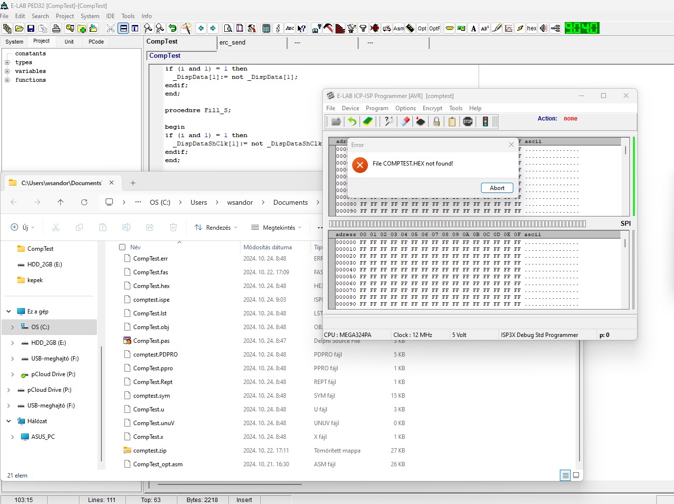

Unfortunately I run to a bigger problem: as you advised I reverted back to the original PED32 from PED32New, but I realised I can't program any projects from there. The Programmer always drop an error window that it doesn't find the project's hex file. I attached a screen capture from it. If I do the same from PED32New it works normally. Could you help me please, what could be the problem, because before the update everithing worked fine.
