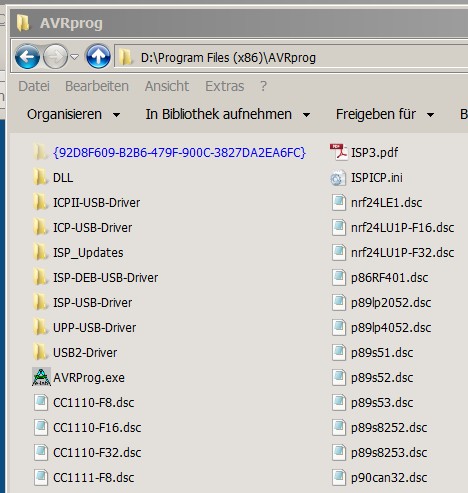

Re: ISP-3 driver for Windows 8 64 Bit
Gepostet: 20.06.2014 - 15:35 Uhr  ·  #23
is should look like my attachment.
I'll check it tonight.
PhilG
