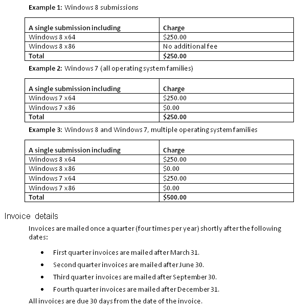

Gepostet: 26.10.2012 - 16:00 Uhr  ·  #5
Re: ISP-3 driver for Windows 8 64 Bit
Gepostet: 26.10.2012 - 16:44 Uhr  ·  #6
where did you see these 99$ ?
I found a verification supplyer which wants $200 each year for renewals...
Without any info about the first step costs.
Below you can see MS fees. Four times $500 in a year :devil:
