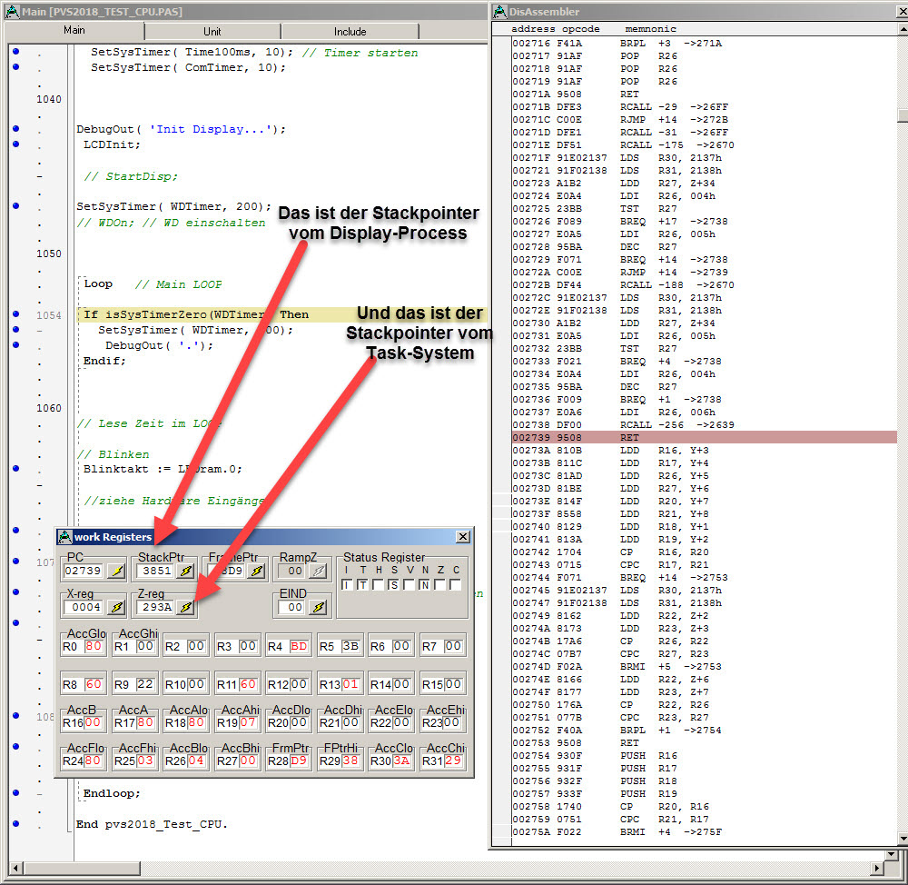

Kein Fehlerhafter Zugriff auf den TaskStack-Bereich? hmm...
Beim Stop auf dem Bild sieht man doch eigentlich klar, das im Bereich des Display-Process (StackPtr 3851) im Z-Reg die Adresse auf den Stack des Task gesetzt wurde, bevor der Stop ausgelöst wurde.
Ich bekomme dauerhaft immer wieder den CheckStackValid() als Überlauf angezeigt und der Freie Stack-Speicher ist "-1" :-(
Kann ich einen Stop auf das ZReg legen? Damit ich herausfinden kann, wo und wann die Adresse 293A ins ZReg geschrieben wird?

The ZReg comprises 2 registers, _ACCCLO and _ACCCHI. But even if you can put a stop on these locations it will not really help, because they change all the time. Besides, 293Ah ($TASKS_stk_chk) is loaded to these registers whenever you call CheckStackFrame, so you may be chasing a red herring.
Hi Merlin,
ok, I can see that. But since I do not access the task stack with any of my functions or routines, either directly or indirectly. Can it really only be a driver problem during compilation or it is loaded at runtime a wrong address from one of the graphic functions.
At the stop, I can see that this is happening in the display process. The system is running, but always shows stack overflow.
It is then only a matter of time until the malfunction occurs during operation. So the faulty memory access has to get out of this!
Any idea how I could find this mistake?

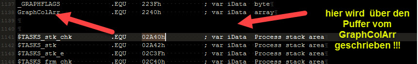

But knowing how the system works I would be looking for something like a buffer overrun. The buffer immediately below the stack areas is GraphColArr, so I would be looking at anything that sets elements of that to $FF. The space allocated to that array is 2K (2048 bytes) so any +1 error would overwrite the task area, and certainly cause problems. (Well, strictly needs to be more than +1 to actually cause problems).
But the only places that I can find this array referenced are in the system routines system.gDispRefresh and System._GraphCmd. _GraphicCmd(1) does initialise the entire 2K, but I can't see any obvious overrun there. Similarly system.gDispRefresh treats the display as 32*64 bytes, a more likely place to see a problem, but again, it looks OK to me.
So all of that is no help at all! :-(
It does kind of support your suspicions that it may be in the graphic area. Maybe something like trying to draw off the edge of the screen or something like that.

ich habe die fehlerhafte Funktion eingekreist, bitte kontrolliere mal Deine Funktion
"gClearView(wmClrPix);"
Diese schreibt über den GraphColArr, so wie es aussieht wohl nicht viel. Aber ich bin wie gesagt kein ASM Programmierer.
Vielleicht hat es was mit der Pixcel Anzahl zu tun? Schleifenfehler?

Beim Fuß hatte ich noch 262 anstelle von 255 drinnen (war noch aus den ersten Versuchen).
Sobald man hier über den echten Wert kommt schreibt der Graphics-Treiber über seinen Speicher, wahrscheinlich nur eine Adresse weiter.
Habe die Funktion bei mir rausgenommen und lösche den Bildschirm mit
     gFillRect(0,0,255,63,$00);
Also hat die Lösung für mich erstmal ein paar Tage zeit :-D
War jetzt ne Menge Arbeit, aber jetzt bin ich mir wenigstens sicher, dass ich keinen STACK Überlauf habe.
