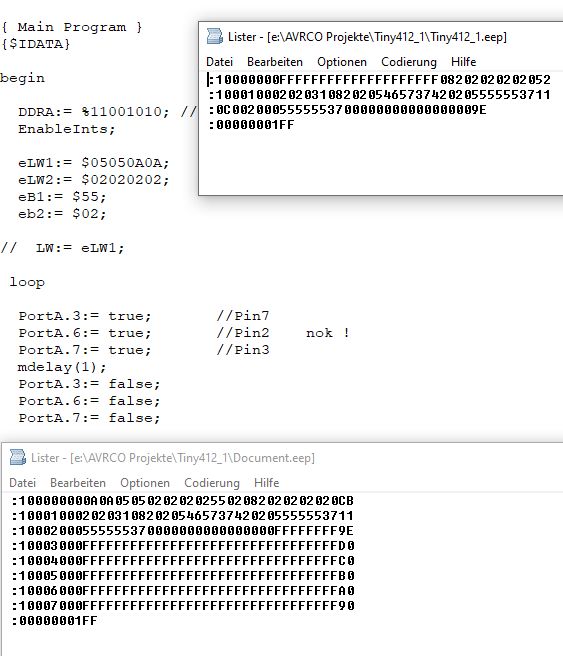

Hi Miparo
Also Atmel files start from 0!
Forget the EEprom offset in the hex file, it is only used internally.?
Not sure that I understand.
For example, if I leave the offset at $1400 for Tiny412 eep file, the Atemel ICE will accept? That is not what I understood from a user who manually changed the EEPROM offset to zero and then wondered why his program didn't work!
Or are you saying I can adjust to zero and ISP3-X will accept?

attached org ATmel *.epp picture.
All files begin at address 0
"Or are you saying I can adjust to zero and ISP3-X will accept? "
Yes

Thanks Miparo. That is good.
