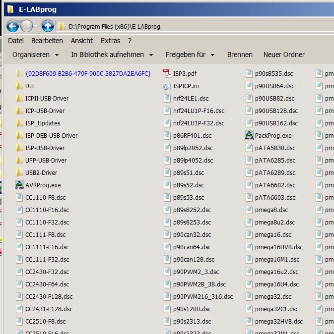

Hi Phil,
I tried a new installation with a new download of ISP_ICPinst.exe.
I changed nothing but the destination letter from C: to D:
Here is the result

Hello Gunter,
I can't explain why it is happening. I downloaded ISP_ICPinst.exe fresh from the website and installed it on my G:\ and got same result. I even selected the German version just in case there was a difference. The download path from either the German/English pages of website is the same. So why it doesn't put the newer driver folder in the folder list, could be a Windows 8.1 issue!
Phil.

Hello Gunter,
Just looked on a Windows 7 machine I tried yesterday and the USB2-Driver folder is there. Obviously doesn't get installed on the Windows 8 install!
Phil.
