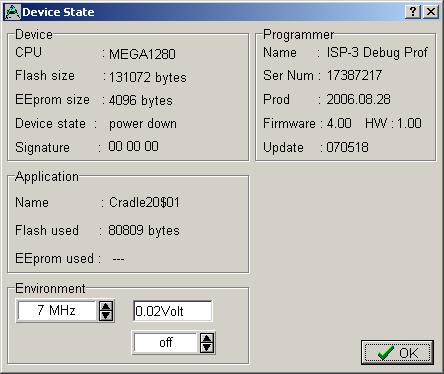

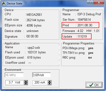

please take a look onto the production and update date in the dialog below. If there is a date older than 07/2010 then you should send the device back for a complete update.

the Prod date is 2006.08.28 and the Update is 070518 :-)
I think the update is necessary...

I have received back the programmer and now it works fine, stand alone.
But if I try to compile any project in AVRco IDE, I still get the error message "programmer not found" and compilation is aborted.
