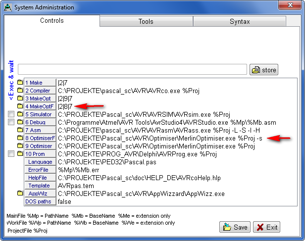

@all,
the optimiser now supports two modes. In addition to the already known (brick wall) there is a fast make mode (1) and a fast optimiser alone mode (2).

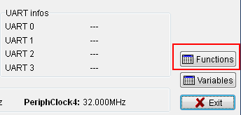

Furthermore the size of functions and procedures can be viewed by the menue "Project/Project information". See the picture below. It depends of using the optimiser or not.
For a correct operation of these two buttons the SysAdmin must be updated. See below.

To add a little technical information, the '-s' option activates the 'Smart_Link_Only' mode of the optimiser (equivalent to using {$OPTI SMARTLINK_ONLY} in the source). Another option '-f' is also supported which performs a single cycle of optimisation (equivalent to using {$OPTI_QUICK} in the source, if you prefer.
