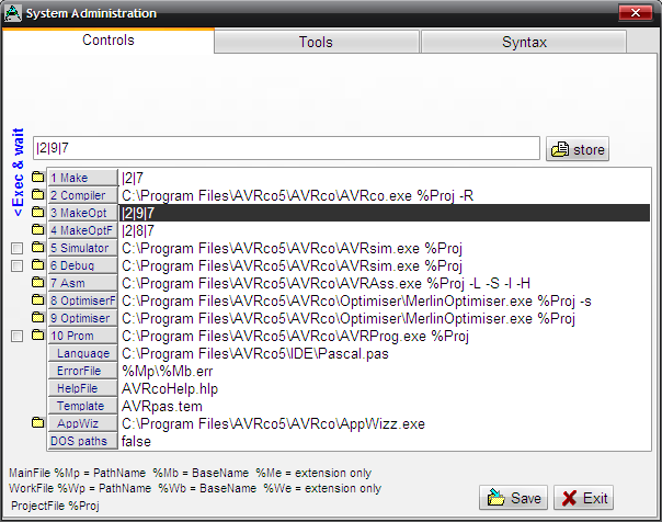

Do you see the optimiser screen flash up when you run any of your options?
The values are substituted by the optimiser when it is run. If it is not run, the values are zero.
I believe that fields are also zeroed if the optimiser is run in smartlinker mode only, but I am not 100% sure about that. Perhaps Rolf can confirm?
Yes, from the flash up screen I could see that optimizer has saved about 26%.
