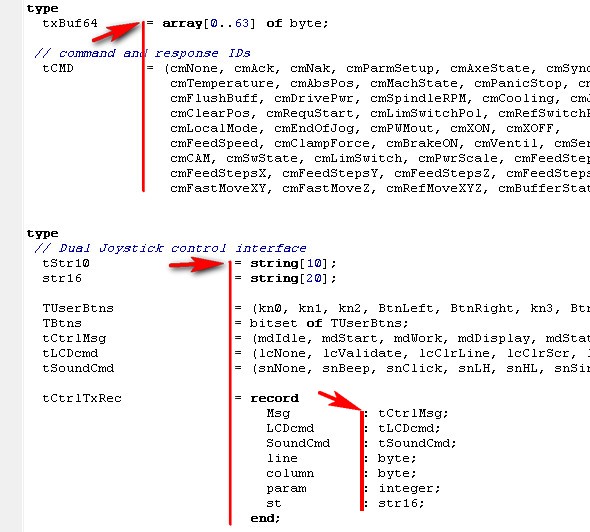

@all,
the user should know how the indent of Types, Const, Var and other define blocks work.
The first appeareance of a ":', ":", '(" etc. defines the indent of the following lines.
If a new Define occurs like Type, const etc. this indent becomes discarded and a new one
begins. See the picture below
