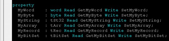

Implementing properties was a nice surprise! You could really see me smiling while reading about it. I don't update too often, but I could not resist this one.
Properties shall make a lot of code look cleaner and easier to read and understand. I have some suggestions. Hopefully some could be implemented easily and would go along with your original idea.
  • property can be colored as a reserved keyword. Let us color read and write keywords too.
  • Let us create read only properties.
  • Let us define color for symbols too (I know, this one was of topic).

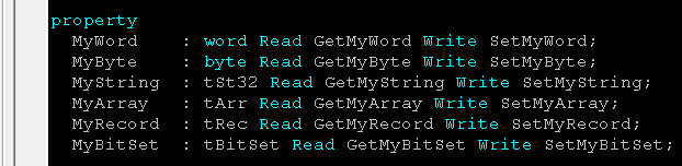

Hello Avra,
it is possible to highlight "property", "Read" and "Write".
But the keywords are user defined and can not be colored.
Maybe a later implementation of the PED can support this.

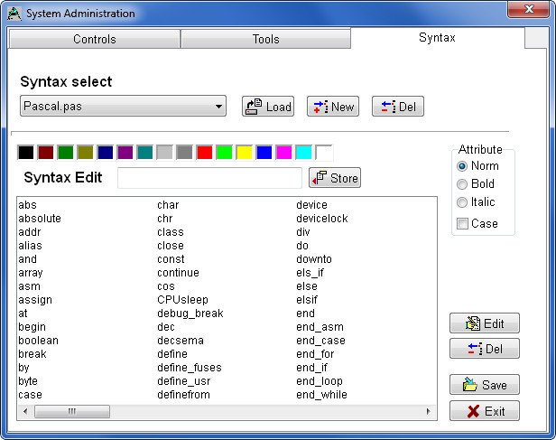

Gepostet: 24.03.2015 - 23:57 Uhr  ·  #3
The way I understand things, "property" has user defined color defined in PASCAL.PAS.LNG file. It would be perfect if "read" and "write" can have that same color, or even better you let us define the color by adding them too to PASCAL.PAS.LNG.

Hello Avra,
user defines of system words, defines etcetc. is already possible here:
