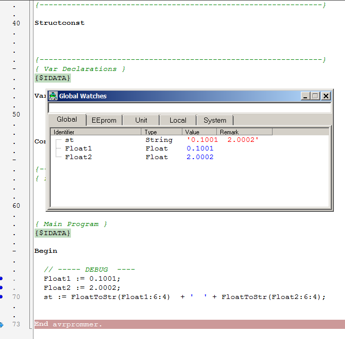

Hi.
I found no problem with 5.09.18

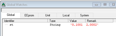

Allan, Gunter,
I also checked this example
