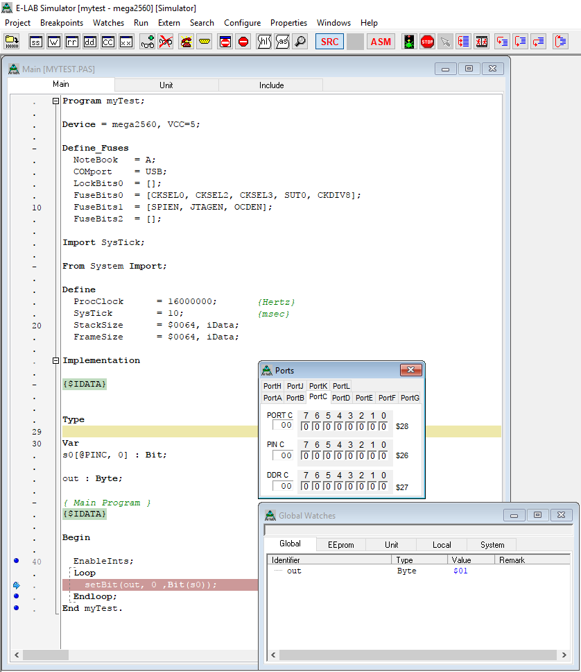

setBit does not compute correctly when compiling with Optimisation.
The screenshot shows the wrong result in the variable out, which should be zero.
Thanks for bugfixing this issue.

Hi Thomas.
I will check this out. It will speed things up slightly if you can send me the asm and dsm files via pm.
Thanks

Hi Thomas.
No problem. I have managed to recreate the problem and am working on it.

Hi Thomas.
I now have a fix for this problem and sent it to Rolf for inclusion in the next release.
If you need it sooner, drop me a line via pm with your e-mail and I will send you a dropbox link.
