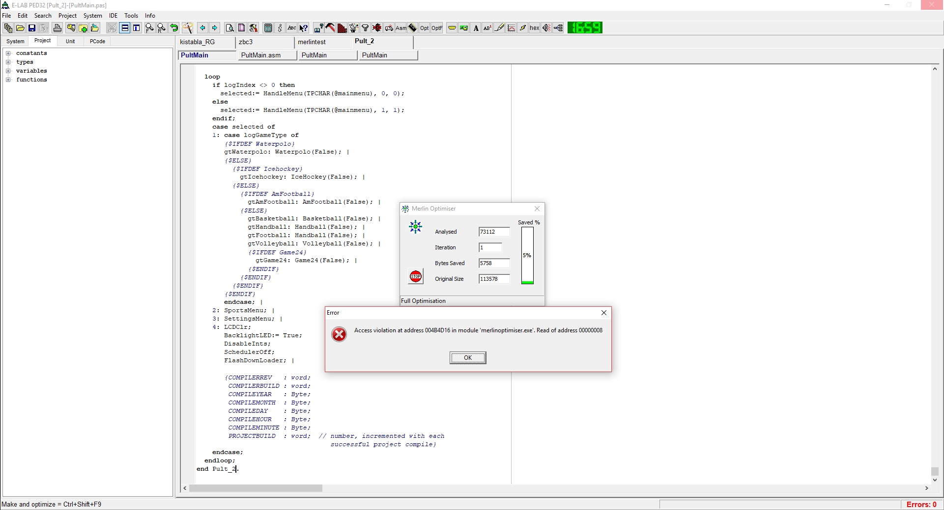

For my test project the new version solved the problem, the lines aren't missing anymore. However with my original, full project the new optimezer throws an Access Violation error. So I can't really use it...
I attached a screenshot about the error.
Re: Merlin error?
Gepostet: 04.04.2018 - 17:27 Uhr  ·  #5
Please send asm and dsm files (zipped) via pm and I will check it out.

Re: Merlin error?
Gepostet: 04.04.2018 - 23:20 Uhr  ·  #7
Hi Sandor.
Thanks for your code.
The optimiser crashed due to a syntax error in your hand crafted assembly code. However, because the built in AVRCo assembler allows this syntax error, I have decided that the optimiser should also allow it and have sent you an update via pm. I have also sent the update to Rolf to be issued in the next release.
