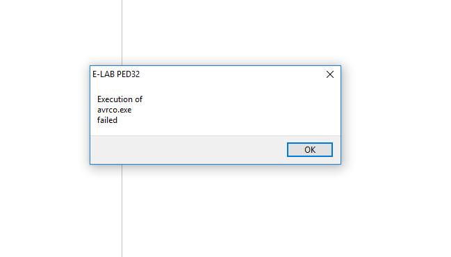

I have recently installed E-LAB PED32 on a new windows 10 machine and have no issues compiling until I restart the program, in which case I get the message "Execution of avrco.exe failed". The only way around this so far is to reinstall the whole program every time before I restart. Has anyone else had this problem?

please set the properties of ped32.exe to "run as administrator".
use the context menu (right mouse button) of ped32.exe

Thank you, sorted!
