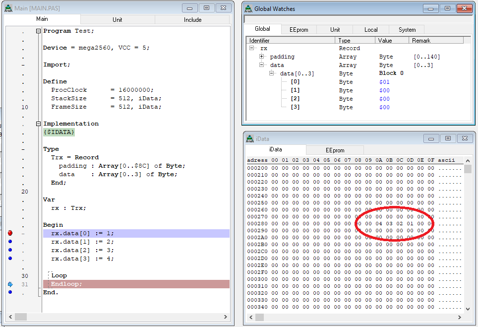

Hello Merlin,
the optimiser calculates wrong addresses.
Please check it.
program Test;
Device = mega2560, VCC = 5;
Import;
  ProcClock      = 16000000;
  StackSize      = 512, iData;
  FrameSize      = 512, iData;
implementation
  Trx = record
    padding : array[0..$8C] of byte;
    data    : array[0..3] of byte;
  rx : Trx;
  rx.data[0] := 1;
  rx.data[1] := 2;
  rx.data[2] := 3;
  rx.data[3] := 4;
end.

Yes, I will look into it Thomas.

Hi Thomas
I have sent fix via pm. Please try it out and let me know if it solves your problem. I have also sent fix to Rolf.
Merlin.

Thank you. I am going to check it on friday.

Sorry Thomas - there was an issue with the code I sent you.
I have send new version to pm.
