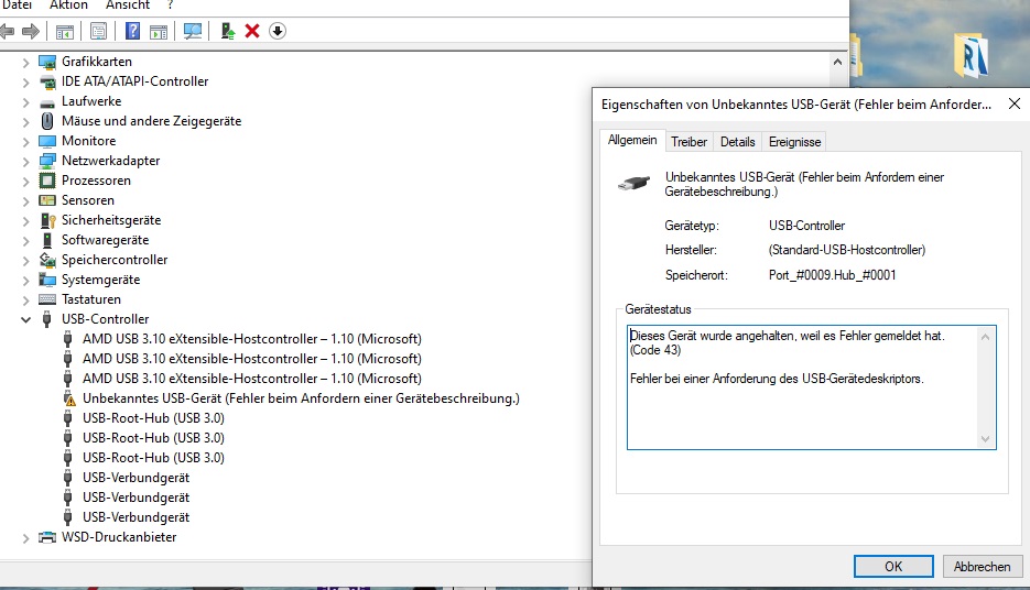

USB Steckeranschluss
1 Plus
2. D- nach Pin32 Xmega
3. D+ nach Pin33 Xmega
4. Frei
5. Masse
Was zum Geier ist das ?

Hello Merlin, I restarted my computer, but it still doesn't work.
But I know that my circuit board is ok, because everything works with my wife at the computer.
Now I don't know what to do next ...
No USB_Port or USB_Smart or USB_CDC go to my Windows 10 computer
I think you are right, there is a driver that causes problems.
Well, let's wait until other users report who also have this problem after an update.
Greetings Frank

installiere die libusb-win32 mit dem Zadig Tool dann laufen die auch unter Win10 richtig.
