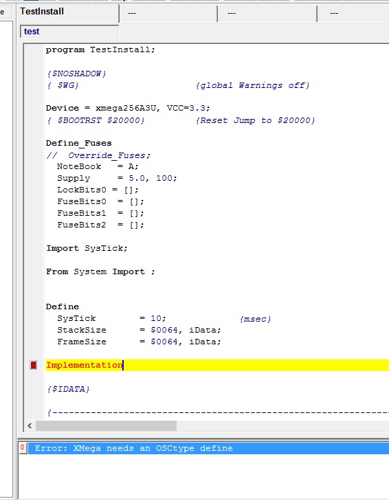

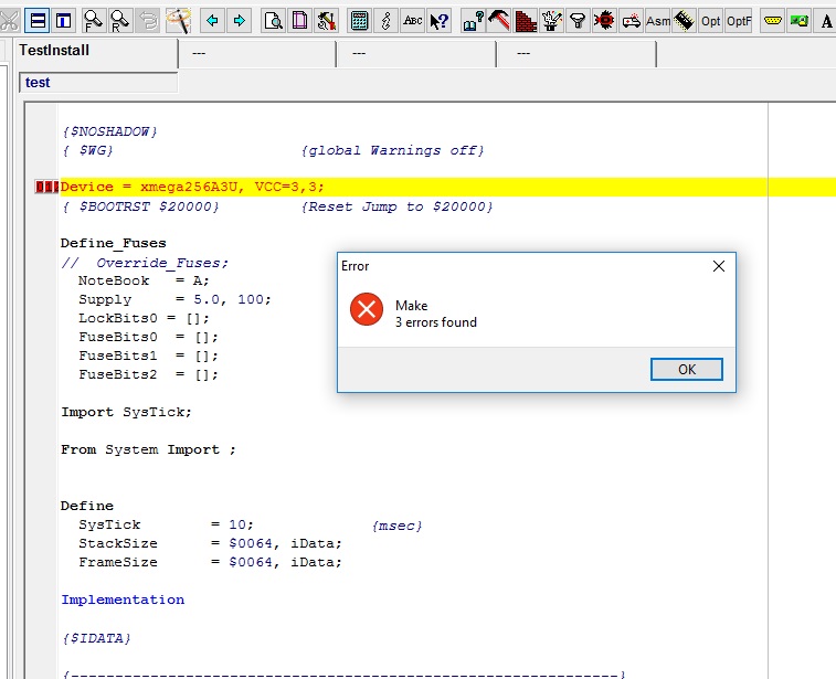

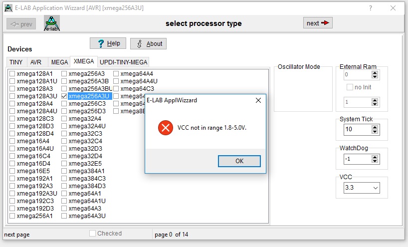

1. Create a new project, I select my 3.3 volts for X Mega here, I have to know that I have to write 3.3 in the field, otherwise I can't continue. There has to be a comma.

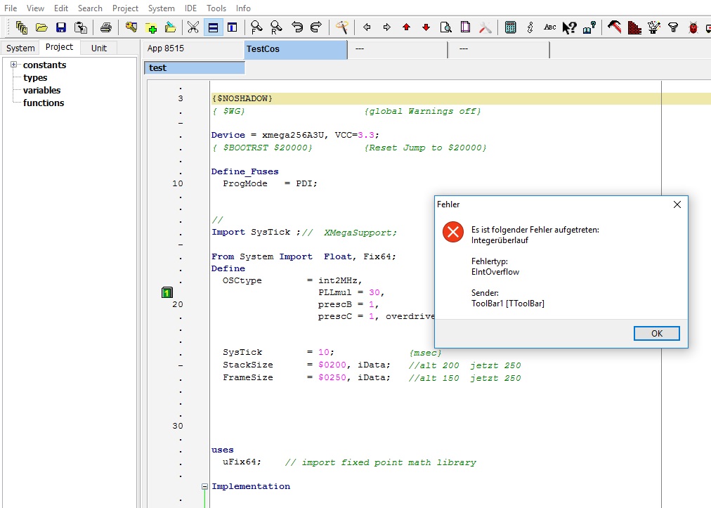

2. In pic2 I now need to change VCC3,3 to VCC3.3.
3. Since I have selected an XMega, I have to enter the OSCtype manually.

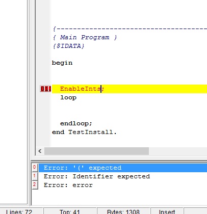

4. In EnableInts I have to manually set EnableInts(87); enter.

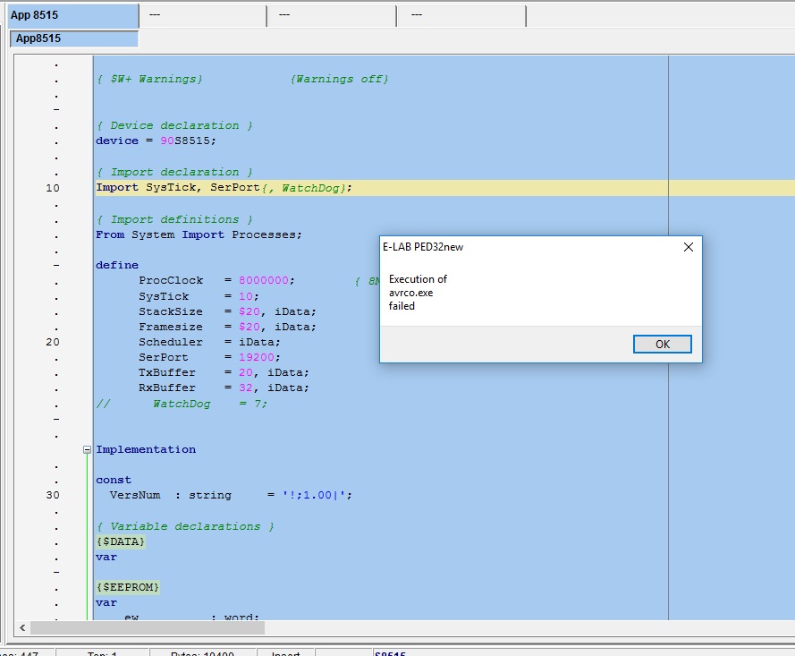

I started Ped32new.exe, miparo please have a look at it
image Pederror.jpg.
Now I deleted the old Ped32.exe program and changed Ped32new.exe to Ped32. In addition PedError1

Hello Frank, Miparo and all.
I am just looking at the voltage element that you mention, Frank. It is a drop down box with three options, 3.0, 3.3, and 5.0, but you can type in anything you like. It seems to me that 3.0, 3.3 and 5.0 are the usual voltages to use and you can change the value in the generated code anyway. It makes sense to me to just restrict it to those three option (Drop down list) and prevent the user from typing their own values in, just selecting from one of the three allowed values.

Yes, that's exactly how it should be, select 3 times and that's good, but if I select a value then it says 3.3 and not 3.3. I then have to change the point with the comma, otherwise it doesn't go any further.

Yes, that is a locale issue. I will sort that too.

then when I have created the project, I must in the *.pas file
the , convert to a period.
Hallo Merlin, noch etwas.
wenn ich dann das Projekt erstellt habe, muss ich in der *.pas Datei
das , in ein Punkt umwandeln.

Hi Frank. There will be no comma. With drop down list nothing is entered except one of 3 options and they will contain '.' not ',', and no validation is required, so nothing to stop 'next'.
