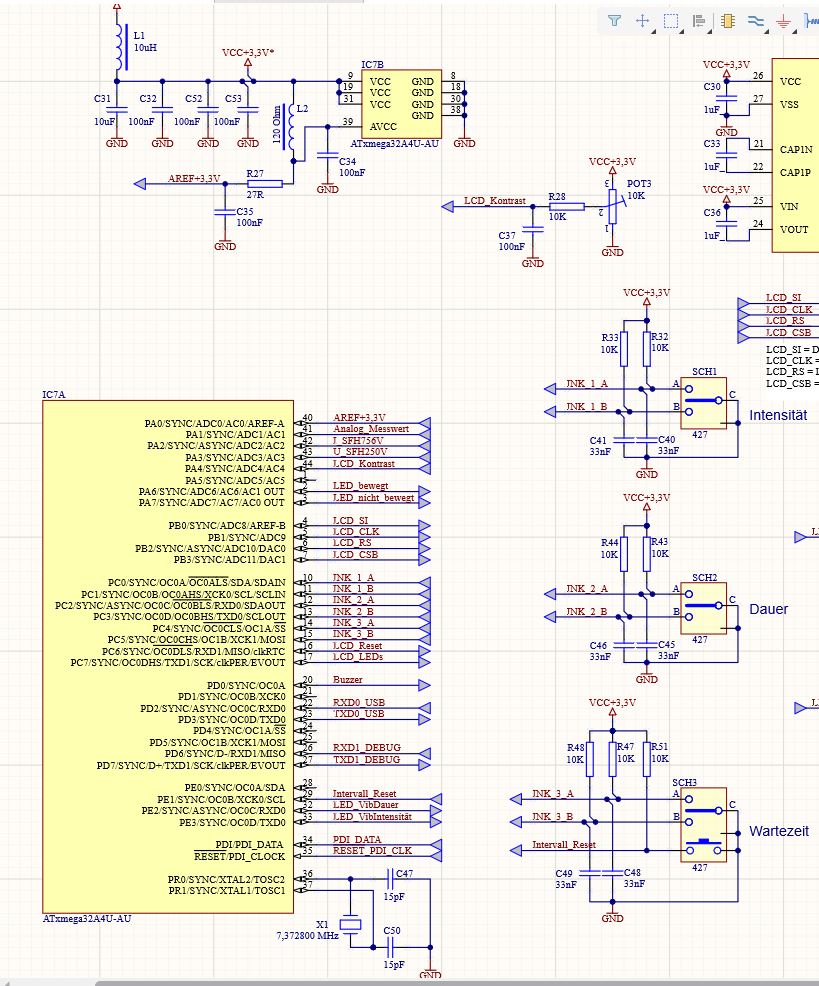

  QDECphase_C0   = PortC, 0, 1;        // Port, Phase0, Phase90 input pin
  QDECevChan_C0  = 0;                  // main event on channel 0..1
  QDECphase_C1   = PortC, 2, 3;        // Port, Phase0, Phase90 input pin
  QDECevChan_C1  = 2;                  // main event on channel 2..3
  QDECphase_D0   = PortC, 4, 5;        // Port, Phase0, Phase90 input pin
  QDECevChan_D0  = 4;                  // main event on channel 4..5

  SwitchPort_G   = [Wartezeit_Reset, PinE, 1], %00000010;
  PolarityP_G    = %00000010;          // Polarity SwitchPort_G
  Debounce       = 3;                  // debounce alle 3 SysTicks
