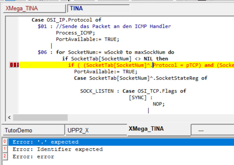

The Xmega_TINA demo project can no longer be compiled.
The inherit in the TTinaSocket no longer seems to work.?

Mmm. For me it compiles. Are you using the standard Demo?

Hi Merlin,
yes last AVRco and standard Demo project.

I have just tested again and for me it compiles fine Miparo.
Are you sure you are using 6.00.07 that fixes some issues highlighted by Thorsten for XMEGA?

Miparo, I cannot reproduce the error. Please send me your asm and dsm files so that I can compare with the ones I generate to see if that gives me a clue.
